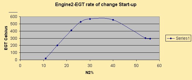

I am working on a solution. However, it is not perfect. The sim will not ignite the fuel until 22%n2. So I have had to make an "overlay" code that moves the needle from about 11-12%n2. In the mean time the sim code catches up and passes the overlay code. However, this results in a pause at around 300c for a second or so. I can slow down the overlay code to reduce the pause but obviously there comes a point when the perceived needle movement is too slow. So at the moment it's a bit of swings and roundabouts to find the best compromise which unfortunately it will always be.

Post by vololiberista » Sat Feb 25, 2017 9:25 pm
Ollie aka Bobisqueen does this float your boat? It had better lol as it was a lot of work. I did have help from an expert at FSDeveloper.com who specialises in creating look-up table formulae.
https://www.youtube.com/watch?v=DNaiRo9o5q0 This all works nicely now. I would still like to see a close up video if and when you have the time. So that the numbers can be more accurate. Also if your technical notes contain max EGT at various ambient temperatures like -40c, +15c, and +50c.
Currently I have programmed rough estimates. I'm working on the needle speed as it rises a little too fast. Having said that I think it is quite convincing even so!
This is the current profile for the needle movement for engine 2. It traces the movement for the whole light-up process and to engine stable. Where it hands back to the Sims EGT once the two numbers are equal.

It looks much better :D
I don't think there is anything in the AMMs that talks about EGTs at different Temps. The engines are so different and due to older manufacturing techniques and Wear and tear each engine would behave slightly differently. Something you couldn't easy replicate in a sim!
The EGT so behaves slightly different when the start temperature go's over 595c. This is because the limiter starts to trim fuel back so the EGT appears to stagnate slightly. Somethings that's easier to see during a start.
I'll dig out the test bed figures I have and see if the start parameters are recorded

It's quite easy now to programme any specific engine to start-up a bit hot but the EGT is already programmed to be affected by ambient temperature and if you try to start in Kuwait for example you will get a nice hot start. There might be a way to reduce fuel flow at 595c but currently that is hard wired to the physical throttle position. And doesn't respond to enforced changes.
Currently I have set the max/min parameters as
@-40c, max EGT385c
@+15c max EGT545c
@+50c max EGT630c
they seem to be in the ball park at least.
Actually it's not that difficult. The start-up with this new coding is entirely customisable for each engine. And engine vibration is already programmed as the sim permanently records the number of hours for each engine. The vibration meters (bear in mind these are the meters at the base of the EO's panel in the civilian version) are running above 4 so the sim will need some new engines soon!!

Made some adjustments and now the EGT indications are as smooth as a babies undercarriage doors!! An outstanding question though regarding hot starts. 595c is the max. Does the EGT indicate a rise beyond that with the top temp switches at norm? Or do the needles stay at 595c?

With the top temp switch set to Norm, the EGT limit is set to 595. However during start, esp in hot conditions the max EGT may swing past that. (hence the max EGT during start is higher. MK301s fitted to the RAF max start temp is 690)
Because you get a rapid EGT increase during start its possible that the EGT may swing over as the limiter is only basic (if the temp goes over 595 the top temp monitor sends a signal to the fuel control unit to trim back the servo fuel which in turns reduces the output of the HP pump which means less fuel to the burners)
Because it fluid and not electrics, Theres a small delay and the limiter cant control rapid changes, so when the start temp swings over 595 the limiter will try and control it to 595. This means as the limiter starts to take effect the over swing will start to slow and stangnant and drop back. Does that take sense?
I had a quick look at the test bed data I have. It only shows basic start data. a max EGT of 620 @ 19.8c
hope that helps!!!

Yes, that's how I imagine it. It makes perfect sense. At the moment the equation feeds the difference betweeen 595c and the actual EGT into another variable and that is subtracted thus the needle stays at 595c. I will have to introduce another variable to make the needle slow down and back-off as it were.
is that a max allowable temperature or a generally expected temperature?
In this video engine 4 seems to get up 590c before dropping back https://www.youtube.com/watch?v=jD8AOw9uyUs

620c relates to the max recorded start temperature of the engine while it was on the test bed. In this case it was a Mk301 engine SN 8085. It was under going test post a visit to the repair shop.
I really think there's no such thing as a average start temp on the Conways!

Curently Engines 1,2 and 4 get to the 570's and engine 3 gets up to 591 at Shoreham on an ISA day. I'll repeat the exercise at Bruntingthorpe at 8c !!!!
At Bruntingthorpe +8c the EGT's are about 25C less for each engine. So to match the Bruntingthorpe temperatures I'll have to add that amount to the equation. That would mean that all the engines are at risk of a hot start at ISA SL. I suppose with the engines not being new that might well be the case.
