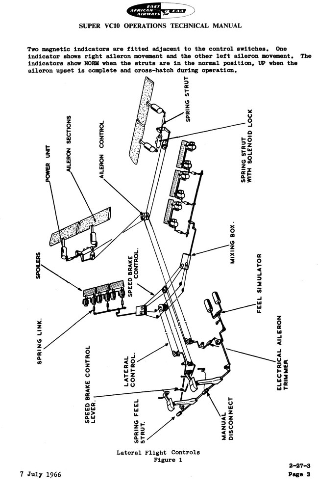

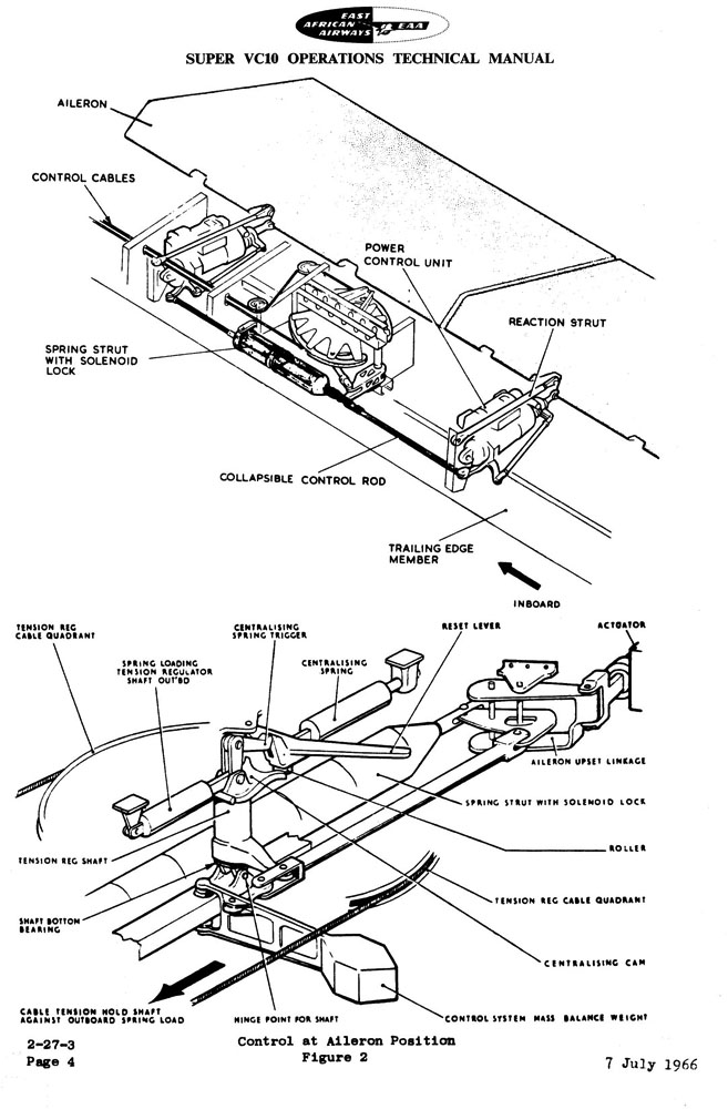

Hello, I dug out a manual and scanned the relevant pages for you. The second image on the last page (just noticed that they are in reversed order, so it's the first one below) may be what you are looking for. I'm afraid this is as detailed as I can provide, Tonks may have better info than this.

Thank you Jelle. The detail pics on page "4" confirmed some of my thoughts on this mechanism, and the rest of the descriptions are valuable as well.
