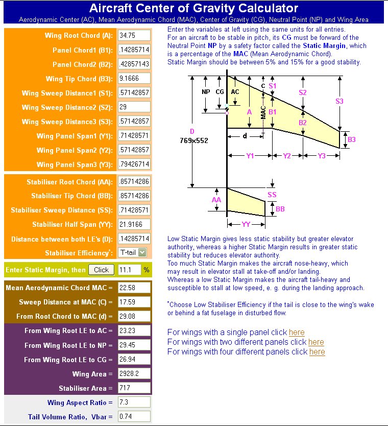

I used this website to get my numbers
http://adamone.rchomepage.com/cg3_calc.htm
