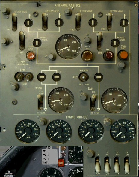

Doing the anti-ice panel was a bit of a challenge in that in the sim there is only one hard coded variable! Easy peasy for the likes of 737 models. But when you have to model an entire panel with switches, MIs different temperature gauges etc. It gets "interesting" as everything the user sees has to work. Which it does surprisingly!!

The switch next to the EGT gauges is for the top temp monitor on the engine. When in Normal it controls the Max EGT to 595c. This is the temp at the rear of the HP turbine in the hot stream and is nothing to do with the bypass or anti ice ducts.
The anti ice duct temperature is control by the temperature control valve and it's controls the anti ice temperature by controlling the amount of P3 )HP compressor outlet) air is mixed with LP4 (LP compressor) air. The temperature is controlled around 230c
The switches on the anti-ice ice panel. The 4 HP stop valves allow the HP compressor air into the anti-ice system. The 2 PRVs ensure the duct pressure doesn't exceed 45 to 50psi. If the HP stops are shut and the PRVs are open, LP compressor air is still allowed into the anti ice system. If the HP stops are open and the PRVs are closed, nothing will get into the anti ice system.
I will dig out some diagrams if that helps?
