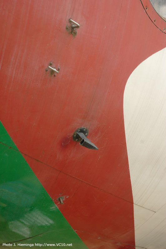

The probes in question are seen above.
The two probes aft of the radome casting the long shadows I assume are part of the set four originals.
Another (I assume) temp probe is slightly forward and above the rotary ice detector - Purpose ?
Finally there is another temp probe aft of the #4 LH window which I assume is the one for calculating true airspeed.
What is the extra probe for?

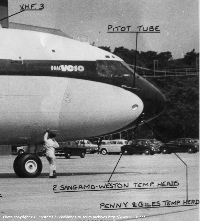

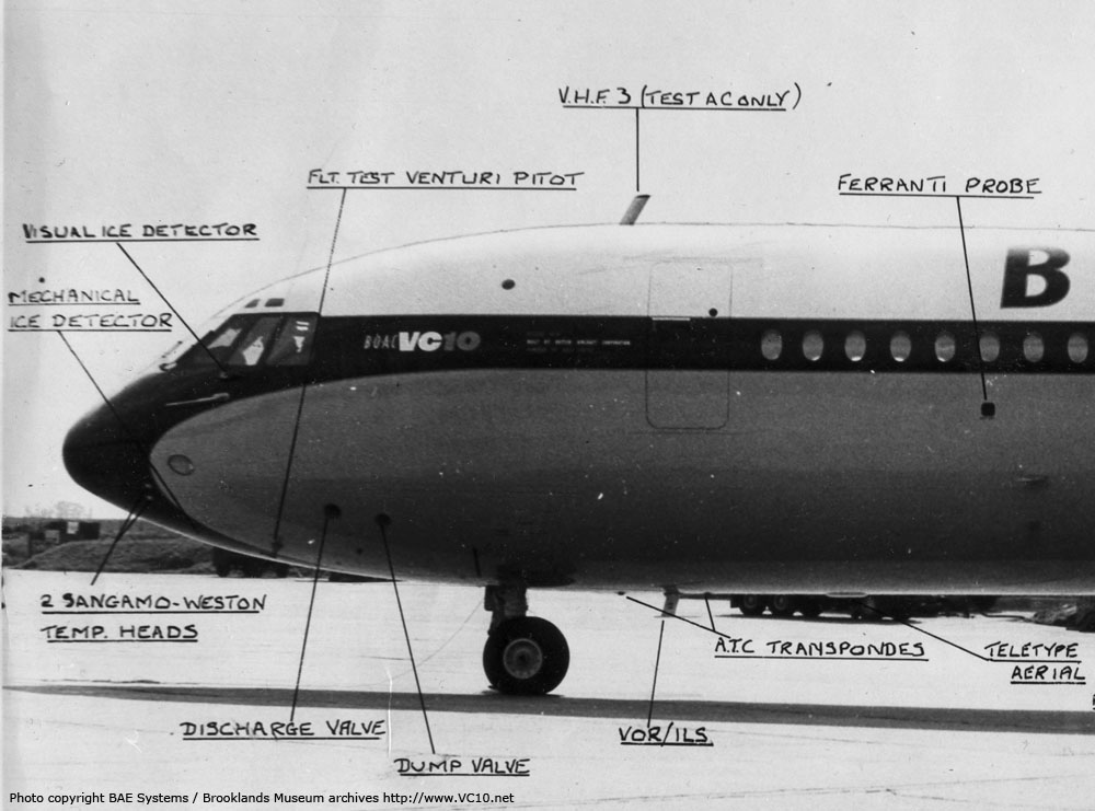

As for the A4O-AB setup, indeed the photo petet16 found (I've enlarged it a bit) shows the three probes on the left side of the nose. I've got a clearer picture as well:
On the first flight of the prototype Super, the configuration was like this:
Note that there is a fifth 'Penny & Giles temp head' on the right side of the nose, is that still installed on the K3?
The K3 tankers have a new FMS like navigation computer which is mounted in the navigator's station, I wouldn't be surprised if the probe next to the no.4 window is attached to that. The one on the bottom left as on A4O-AB would then be for the same system in the front. A bit of guesswork from my side but perhaps there's a grain of truth in there somewhere.

Thanks for that photo petet16.
Based on that I am going to make an educated guess. As A4O-AB has the Rosemount Probe by the ice detector I will say that that probe is for the INS. The one behind the window is for the GPS?

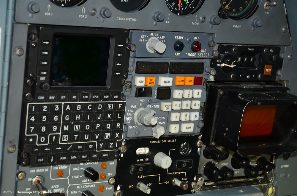

My guess would be that the Rosemount probe next to the ice detector is used for the 'old' INS (grey box with white/orange keys) while the one next to the window is used for the 'new' FMS (large black calculator on the left).

The INS fit was salvaged from the Vulcan fleet when it was retired, the fit for the VC10 was done on the K2's by EWAU at RAF Wyton

You are correct Jelle (as far as I remember... I don't re-read the manuals every day any more!). The old ones were left fitted when the new FMS's were fitted.
