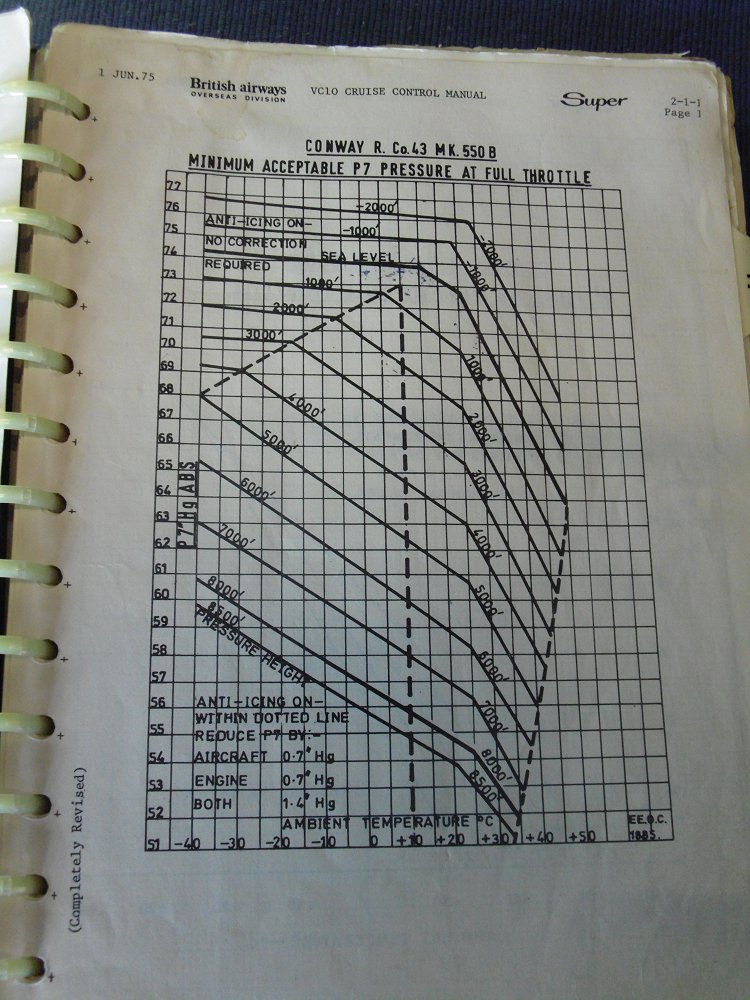

While over in the UK last week I acquired this "for your collection!"
Re: A question about throttle settings
That's a very nice Cruise Control manual! Looks like the larger version (I have an A5 sized version as well). Where did you manage to find that?

Jelle Hieminga wrote:That's a very nice Cruise Control manual! Looks like the larger version (I have an A5 sized version as well). Where did you manage to find that?
I was over in the Uk for a few days and went to Brooklands. It was one of the manuels in the Sultan's aircraft. Which by the way is in a sorry state externally.
