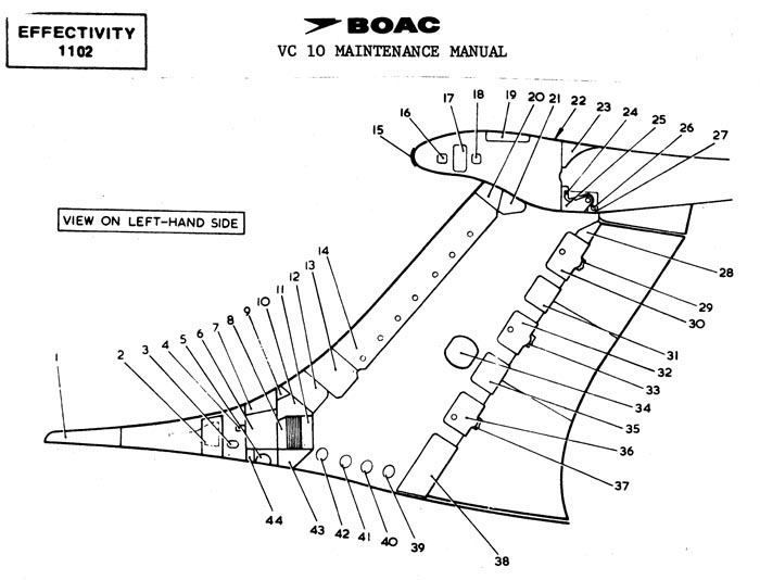

From the 1962 Airframe course notes
Thanks for that! I only have this image:
While it is supposed to cover the Ghana Airways aircraft (see effectivity stamp) it shows the anti-ice exhaust air vents as on the fin tank configured aircraft. Mistake by BAC?
