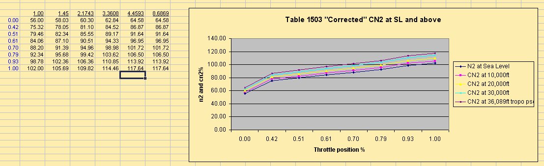

Before your reply I did some calculations to obtain CN2 and got the graph below. If 50% throttle equates to 90%n2 then then the second half of throttle travel would only be 10% of n2 90-100%. and the graph would effectively be a horizontal straight line. It's easily changed if that is indeed the case.
