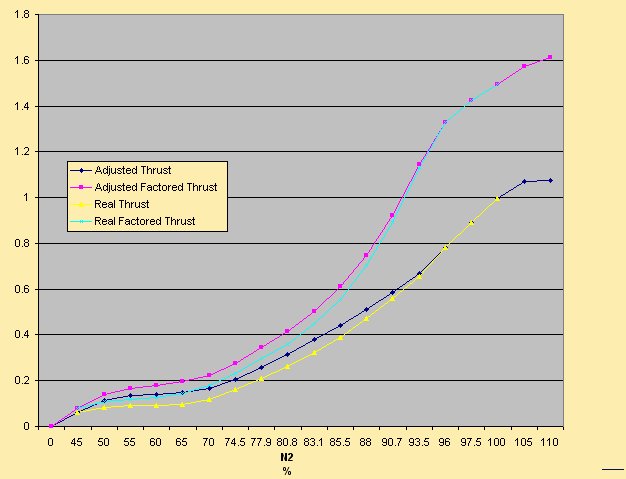

You don't get that characteristic Conway roar and thick smoke until about 92%cn2plus in ISA conditions. At 80% you will hear them sing and that's all. To be honest such a low fly past with the engines "already" at idle is a very risky manoeuvre as there is no power left in the engines to climb out safely as was clearly demonstrated at Habsheim (and I don't think he was in ground effect either). Think of the number of accidents there have been where engines were closed to idle leading to too high a sink rate which could not be recovered from once identified.bobisqueen wrote: Wed Feb 15, 2017 7:46 pm What gives it away for me is theres little to no black smoke coming out of the engines and also you can hear the engines whisting. Both signs the engines are at lower power settings. At 80% HPRRM the engines start to roar more. Theres also only 20% HPRPM from 80 to max!
I certainly would be loath to close the throttles to full idle doing this even though at White Waltham he was clearly in ground effect. Here are a couple of graphs I did to correct David Maltby's air file tables for his FS9 model. He used the stock MS tables for all his aircraft. They all suffer from engine surge at start-up and all have exactly the same thrust be they a Super VC10 or Comet.
The first graph is the real actual thrust from a Conway 550. You can see that it really doesn't do much until above 85%n2. Most of the thrust is generated in the last 15%n2. That is typical of this type of jet engine. The numbers along the top are the polynomial curve that I used within the sim and subsequently corrected as seen in the second graph.
The second graph shows corrected n2 which is done to calculate actual thrust at different altitudes/temperatures etc and that is what is used by the desktop sims. Particularly a problem with FS9 and FSX as the way they work means that at both ends of the curve there is not enough thrust. So the real thrust curve has to be adjusted so that the correct thrust is seen in the sim. You can also see in the second graph why slamming the throttles to max at hot airfields like Kuwait is a no no! As n1 would overspool big time! All that has to be modelled in order to get the correct thrust at various altitudes and temperatures. This graph was the original transcription from the data I had. It shows a much steeper curve only because of its scale. But you can see clearly demonstrated that all the useful thrust is generated only at the top end. The difference in scale between this and graph no.1 is to scale it to the relevant air file table in the sim.

I'm well aware of the facts and figures, having spent 8 years working VC10s and now look after 241 at Brunty. Engines where also my Base trade. Any figures I use are based on Maintenance manual or mk301 test bed figures I have.
I can guarantee you at 80% HPRPM she generates plenty of black smoke and she certainly doesn't sing at 80% HPRPM. The distinctive conway noise is produced at around 96/97% and a lot of that distinctive noise is made by the cabin compressor.
The conway produces half thrust at approx 90% (I have test bed results to confirm this) and the throttle position matchs this. Ie 90% = HPRPM = half throttle = half thrust.
Also you can slam the engines in any condition as the FCU will control the accel in within limits and regardless of where you are they will not stall. This was part of a post engine change check regardless of conditions. Around 3ish seconds idle to 90 and 1 to 1.5 seconds 90 to max.
The engines are certainly within the lower power setting and if the flypast was conducted with lots of energy with a relatively light weight, there would be no need for loads of power, however I never said they were at idle.
